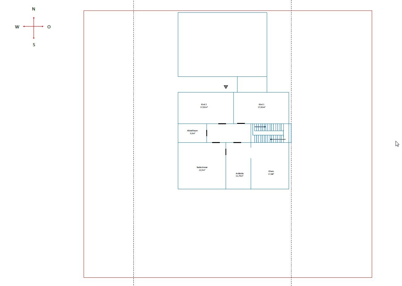

Good afternoon everyone,
I have taken your advice to heart once again and tried to put the latest designs on paper as best as possible, based on the existing sketches (hand drawings), though I am not an expert.
Option 1:
for a larger view as PDF
Option 1.pdf
The ground floor shows the entrance block described by @ypg between the garage and the front door on the north side. I personally really like this design, but due to the layout it would take away 2 meters (6.5 feet) in the south. The stairs are positioned to take advantage of the nice view to the east (possibly also serving as a gallery replacement with very tall, continuous windows / window front). The kitchen is located directly to the west, including a pantry which I personally do not want to give up. The dining and living areas can be flooded with natural light from large floor-to-ceiling windows facing south, enhancing the atmosphere.
The upper floor is fairly straightforward, laid out with straight lines and no unnecessary frills. I personally don’t think a children’s bathroom with a shower is necessary. But as with the pantry on the ground floor, opinions differ.
Option 2:
Option 2.pdf
The ground floor shows the garage attached directly to the house. In bad weather, you can walk through the utility/technical room into the house without getting wet. The front door faces west, towards the street. A roof extension or awning provides some protection right at the front door. The stairs are positioned to the north and have a long, narrow window that brings plenty of light into the stairwell (garage with a flat roof or low-pitched hipped roof, e.g. 25 degrees). Walking through the hallway to the living room, you are greeted by a large floor-to-ceiling window wall stretching all the way up to the ceiling towards the east (nice view). (See example below of what I envision.) The office/workroom has an exit to the south-facing terrace. Kitchen, living, and dining areas are arranged in a small L-shape. Between the living and dining areas, there is a gallery opening upwards. The terrace is accessible from the dining area through a large sliding window wall.
The upper floor is also quite straightforward. The rooms are a bit smaller than in Option 1 because the gallery with the large window front on the east enhances the view further.
I hope these new drafts present better versions of the designs, which we believe show the two best possible options.
Sample images of window fronts for Option 2
I would be grateful for any improvements or feedback from you.
Andreas

I prefer option 1 in terms of orientation compared to option 2.
On the upper floor, I would position the children’s bedrooms on the lower side of the plan (south) and move the other rooms upwards. You don’t need 30m² (323 ft²) for the bedroom and dressing area, nor 22m² (237 ft²) for the bathroom.
The staircase is planned very generously (too large), but that will be adjusted in the detailed design stage.
A wardrobe could also be added below the guest toilet. Depending on how the entrance area is covered, it could be quite dark there and in the hallway. Option 2 has advantages in this regard.
The pantry is very narrow in both options.
May I ask what the overall budget for this project is?
