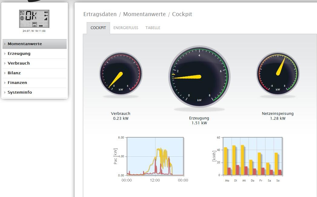

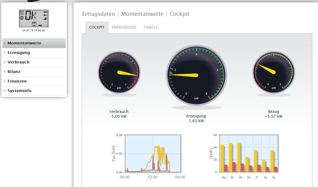

It’s actually even simpler... I just had a mental block. I checked the power consumption meter. Current consumption is 230 W (computer, base load). Then I turned on the hot water (40°C (104°F)) in the shower and looked at the meter again. Consumption: 5 kW. Turned the tap off, checked the meter again: 230 W.
So the tankless water heater runs at about 4.7 kW at 40°C (104°F) while showering. Minus the power for the booster pump that ensures water pressure, which is 500 W (measured the same way but with the cold water tap). That leaves 4.2 kW purely for the water heater out of the 18 kW maximum capacity.
