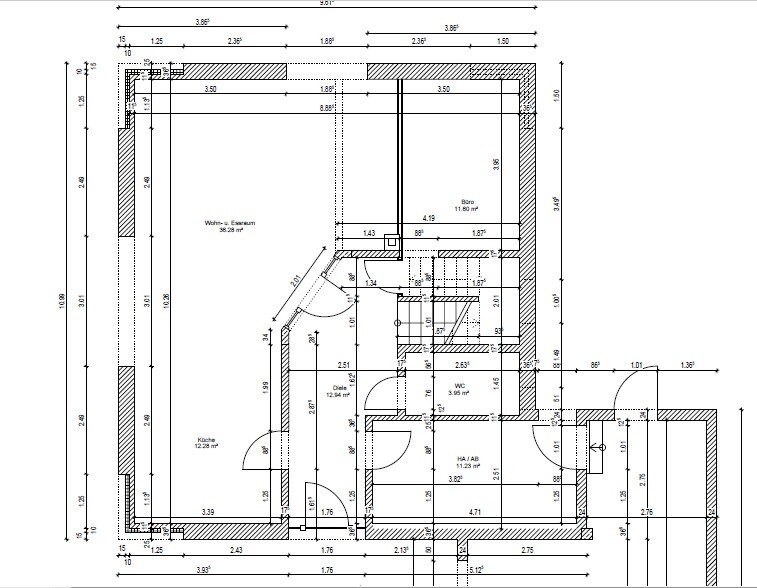

readytorumble12 May 2016 10:52Interesting question, which I have been thinking about as well.
I’m attaching the ground floor plan here.
The door from the hallway to the living room is meant to be a feature, as it is visible directly from the main entrance and represents the focal point of the house.
Width: 2.01m (6 ft 7 in) rough opening
What type of door would you choose here?
Please don’t take this personally, but the highlight disqualifies itself because it is positioned at an awkward angle both to the main entrance and to the staircase.
No matter what you choose, it will always look "so-so."
Although I’m generally in favor of double doors, in your case a door like the one K1300S suggested might be a better option.
