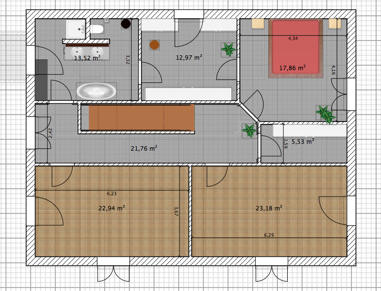

Hi Hausbau,
at first glance, your straight staircase creates very large hallway areas in the house, especially since it runs along the longitudinal axis of the building. Have you considered rotating the staircase 90°? Or maybe going for a staircase with a landing? Personally, I don’t like these long staircases combined with narrow corridors, as they remind me of a hotel hallway. But that’s a matter of taste.
And it seems you want to build without a basement, which leads to the classic problem of needing a huge amount of space on the ground floor to accommodate the utility room and home office, while upstairs you don’t really know what to do with all the space.
Maybe consider making the house significantly smaller and adding a 20 m² (215 sq ft) extension for the utility room that also serves as a connection to the garage?
I find 22 m² (237 sq ft) for the kids’ bedrooms quite large. How long will the little one take to tidy up all that space?
The children’s bathroom is also a matter of taste—we didn’t plan one, even though we have enough space in our 175 m² (1880 sq ft) home.

Bieber081517 Dec 2015 22:21Maria16 schrieb:
At least I know that the risk is too high for me to forget to lock or unlock one of two bathroom doors – or one of the kidsYou don’t forget a child :P, I don’t understand the rest.*
*Hausbau*18 Dec 2015 09:31andimann schrieb:
Hi Hausbau,
at first glance, your straight staircase creates very large hallway areas for the house. Also, because it runs along the longitudinal axis of the house. Have you considered rotating the staircase by 90°? Or using a stair with a landing? Personally, I prefer ........
Andreas Hi Andreas,
you’ve identified my problem.
In the ground floor, my first sketches were already around 18 x 14 m (59 x 46 feet)...
I really have the issue that I want the living and dining room to be relatively large, with a minimum width for a multimedia wall of 4.2 m (14 feet, better 4.5 m / 15 feet) and a minimum length of 5.5 m (18 feet, better 6 m / 20 feet). We already live in a large apartment now (the living/dining area is about 38 sqm (409 sq ft)) and don’t really want to downsize.
I’ve given up on “standard floor plans,” I have a whole office full of catalogs and brochures from prefab house companies and none really appeal to me, unless the living area approaches 240 sqm (2583 sq ft), because then the living room usually meets my requirements.
The idea of an extension has also come up. But I can’t judge whether it’s more cost-effective to add a bay window on the ground floor (with additional roof, insulation, etc.) and make the rest of the house smaller (the architect will hopefully know).
22 sqm (237 sq ft) for the child’s room is really too much; at the prefab house center, we had agreed on a size of 17 sqm (183 sq ft).
@Maria16: I don’t understand the idea of locking/unlocking two doors, I don’t lock the bathroom door now either. And if someone really walks in when I’m standing naked in front of the mirror... Who cares?
A 4.2 m (13 ft 9 in) multimedia wall? The kid in me almost worships that idea… But realistically, I wouldn’t have a use for it, and it won’t improve TV programming. My TV watching has decreased significantly over the past few years.

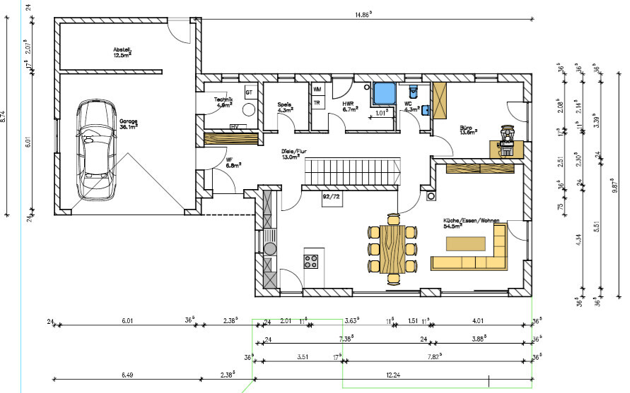

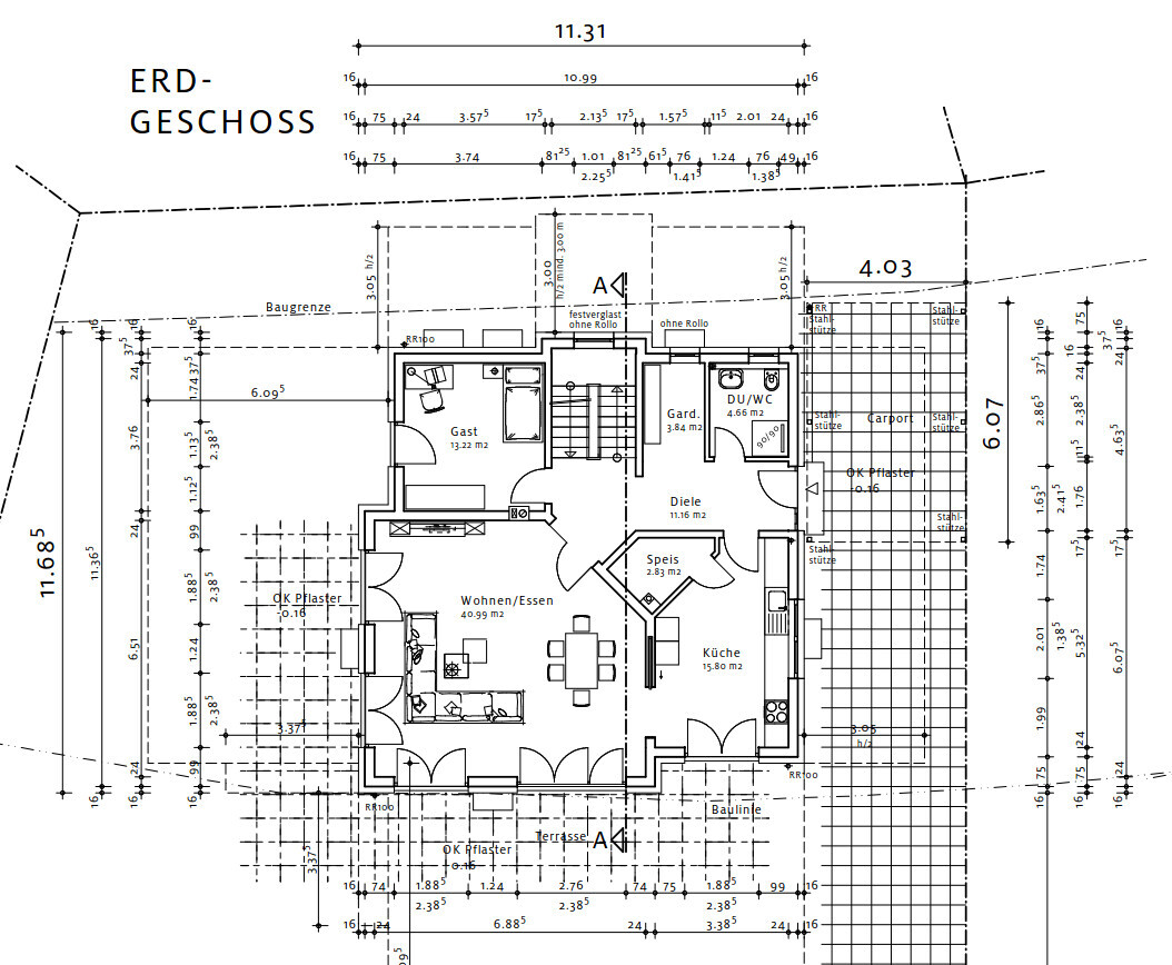

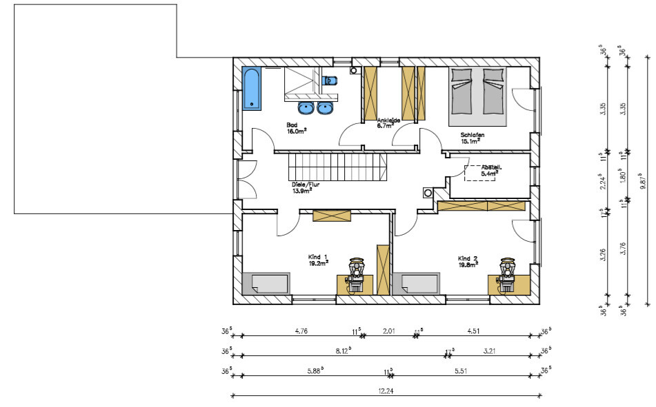

I could just about fit a 4.2 m (13 ft 9 in) wall in our living room. I’ve attached our ground floor plan (not fully finalized yet, but almost). Our house layout is basically square, on a plot of 650 sqm (7,000 sq ft).
You have more flexibility because your plot is bigger. But first, you should consider where the driveways will go, where the entrance should be, and where the terrace fits. A lot will fall into place from there.

If you were to build straight walls in the kitchen instead of the pantry, you would gain significantly more usable space.
Additionally, you could align the living room wall with the hallway and move the staircase in. The living room is rather oversized at 50 m² (540 sq ft) anyway.
With these two changes, you save walls, an interior door, and a recess, while also creating a larger guest room.
The closet with 1.56 m (5 feet) width could also be made slightly wider if needed.
Otherwise, I think it looks quite nice.
Bauexperte18 Dec 2015 11:00Hello,
Just my 2 cents
Regards, Bauexperte
BeHaElJa schrieb:Nope
The living room is rather oversized anyway at 50 m² (540 sq ft).
BeHaElJa schrieb:And a completely boring floor plan. In my opinion, it’s good as it is—functional yet visually appealing, both inside and out.
With those two changes, you save yourself walls, an interior door, a recess, and get a larger guest room.
BeHaElJa schrieb:If ‘andimann’ were to implement your suggestions, there would hardly be anything left that you could call stylish. It would just be one cookie-cutter box among many.
Otherwise, I think it looks pretty stylish.
