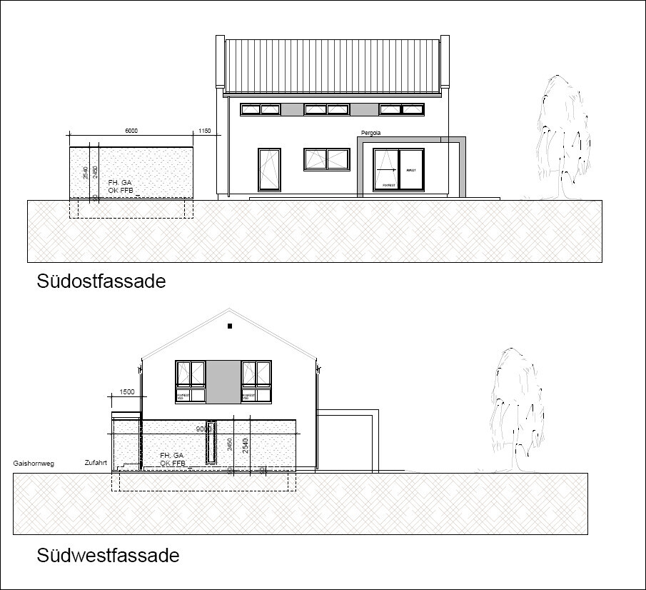

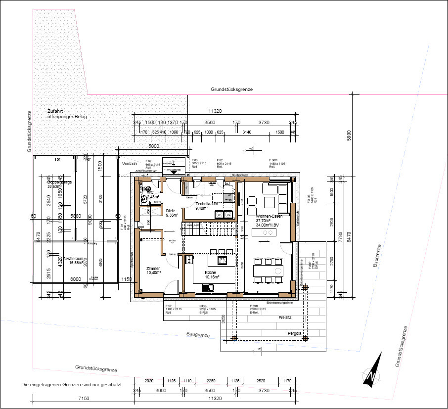

Attached are the first exterior views from our initial facade sample as well as the future floor plan. We will probably swap the walk-in closet with the master bedroom.
We will likely choose a garage door after all; we really don’t like the option with two doors.
P.S. Is there no way to edit, fill in, or add to Post 1?
